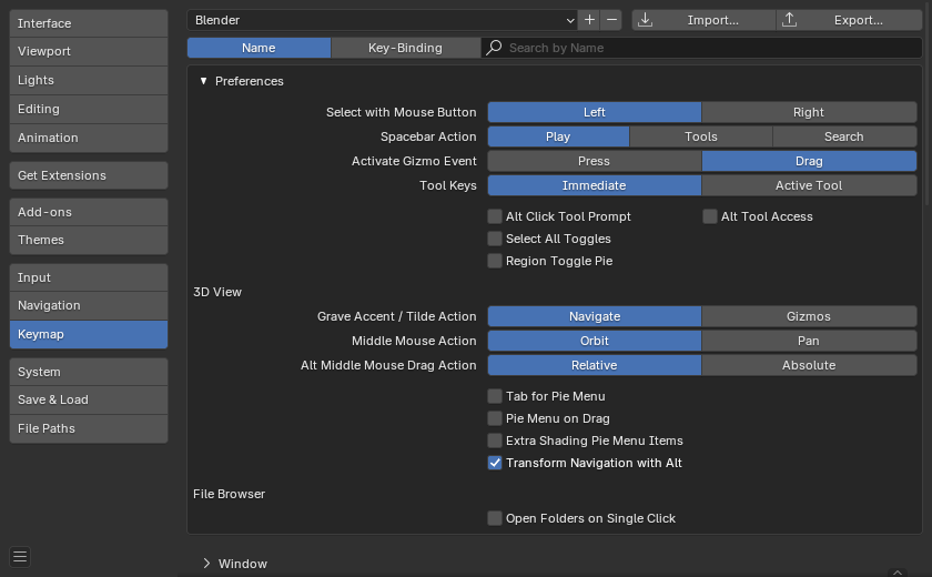

Keymap¶
The keymap editor lets you adjust your keymap via:
- Presets:
Predefined keymaps which come with Blender and can be added to.
- Preferences:
Keymaps may define their own preferences to change the functionality or add additional key bindings.
- Key Map Items:
You may add/remove/edit individual keymap entries.
Blender Preferences Keymap section.¶
Preset Management¶
- Keymap Presets
Select the keymap from a list of predefined keymaps.
You add a custom keymap configuration to the preset list by LMB on the Add button
.You remove a custom keymap configuration from the preset list by LMB on the Remove button
- Import
Importing opens a File Browser to select a
.py
file to add to the list of keymap presets.
- Export
Saves the current keymap configuration as a preset others may use.
- All Keymaps
When disabled, only the keymaps and categories that have been modified by the user will be exported. In addition, add-ons may register keymaps to their respective functions, however, these keymaps are not exported unless changed by the user. This exported file may be thought of as a “keymap delta” instead of a full keymap export.
When enabled, the entire keymap is written.

Preferences¶
Keymaps may define their own preferences, these are predefined adjustments to the keymap you can make without having to manually adjust individual keymap items which can cause problems with newer Blender Versions.
See the default keymap preferences for options available in the default keymap.
