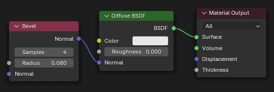

A minimal node setup for working with the Bevel node.¶
