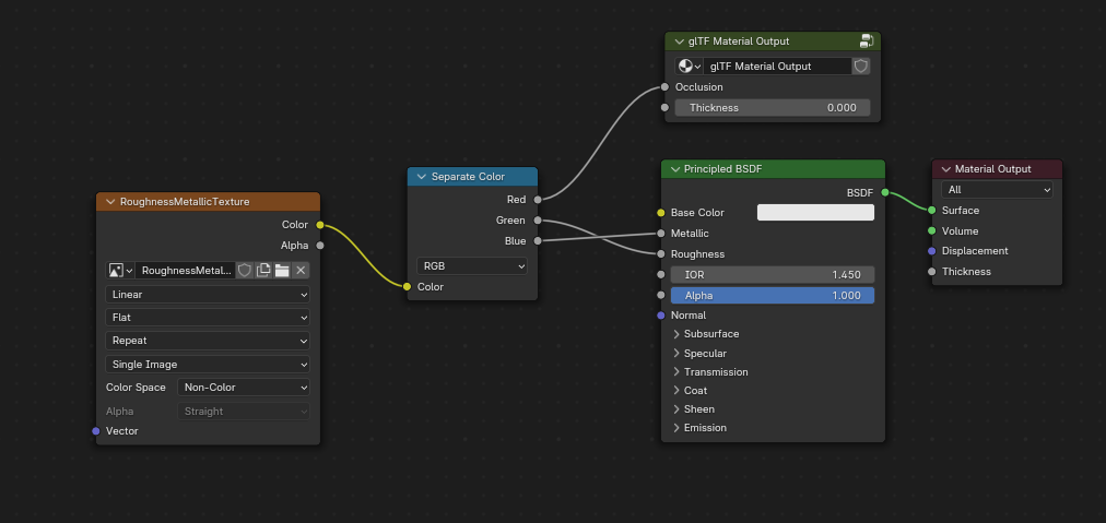

Metallic and Roughness
These values are read from the Principled BSDF node. If both of these inputs are unconnected, the node will display sliders to control their respective values between 0.0 and 1.0, and these values will be copied into the glTF.
When using an image, glTF expects the metallic values to be encoded in the blue (B) channel, and roughness to be encoded in the green (G) channel of the same image. If images are connected to the Blender node in a manner that does not follow this convention, the add-on may attempt to adapt the image to the correct form during exporting (with an increased export time).
In the Blender node tree, it is recommended to use a Separate RGB node to separate the channels from an Image Texture node, and connect the green (G) channel to Roughness, and blue (B) to Metallic. The glTF exporter will recognize this arrangement as matching the glTF standard, and that will allow it to simply copy the image texture into the glTF file during export.
The Image Texture node for this should have its Color Space set to Non-Color.
../_images/addons_import-export_scene-gltf2_material-metal-rough.png
A metallic/roughness image connected in a manner consistent with the glTF standard, allowing it to be used verbatim inside an exported glTF file.
