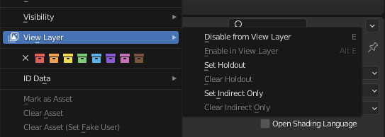

View Layer
Controls the collection's interactions with the View Layer.
../../_images/render_layers_introduction_viewlayer-collection.png
Collection/View layer settings.
Disable from View Layer
Remove this collection from the active view layer. Objects that are only in this collection will not be rendered for the active view layer. This is useful to sometimes leave out some object influence for a particular view layer.
Enable in View Layer
Add this collection to the active view layer. Objects inside the collection will be rendered with the active view layer.
Set Holdout
Enables the Holdout property for the selected collections. Objects inside this collection will generate a holdout/mask in the active view layer.
Clear Holdout
Disables the Holdout property for the selected collections.
Set Indirect Only Cycles Only
Enables the Indirect Only property for the selected collections. Objects inside this collection will only contribute to the final image indirectly through shadows and reflections.
Clear Indirect Only Cycles Only
Disables the Indirect Only property for the selected collections.
Set Color Tag
Assigns or clears a collection's color tag for the selected collection.
