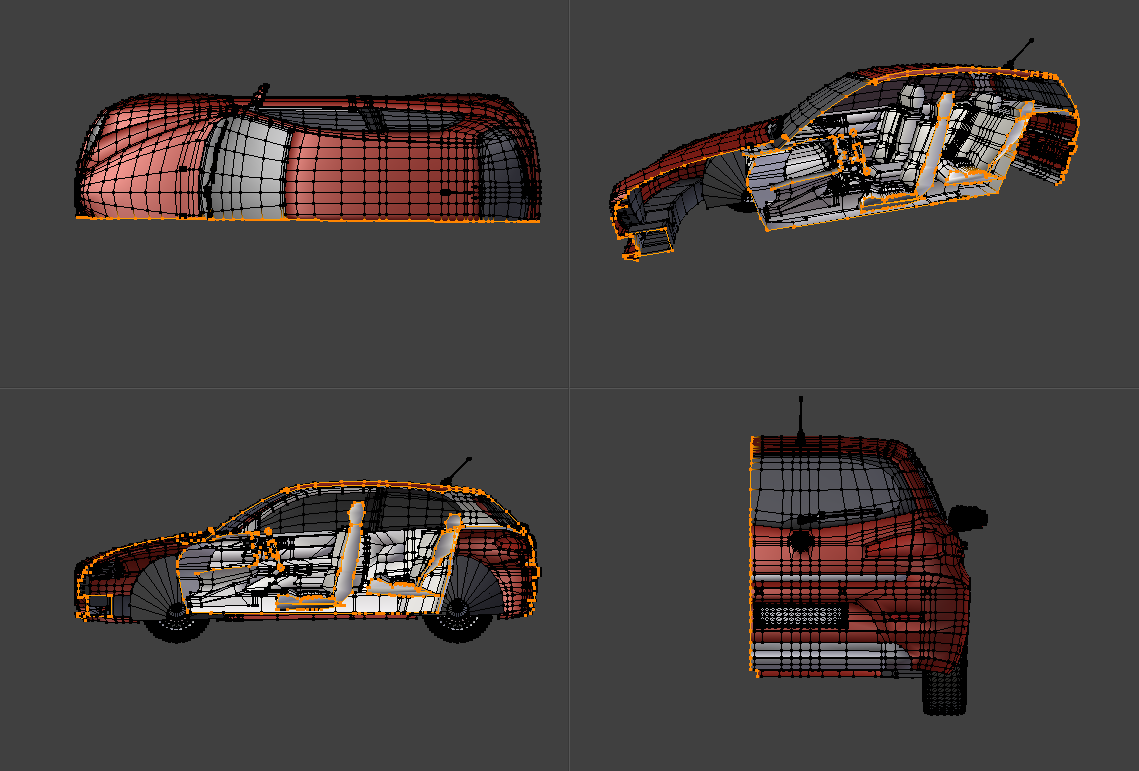

Contoh
../../../../_images/modeling_meshes_editing_mesh_bisect_example.png
Example of a common use of bisect.
