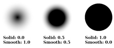

Smooth Radius
An additional radius outside Solid Radius to add a smooth falloff.
If you set "Smooth Radius" to zero, particle will be painted as a solid sphere. If you set "Solid Radius" to zero, it gets painted as a smooth halo.
../../_images/physics_dynamic-paint_brush_solid-smooth-radius-values.jpg
