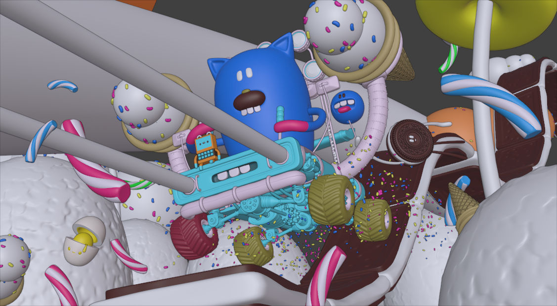

Below is a comparison between the Viewport render and a final render using the Cycles Renderer.
Model by © 2016 pokedstudio.com
../../_images/editors_3dview_viewport-render_example-workbench-render.jpg
Viewport render using Solid Mode.
../../_images/editors_3dview_viewport-render_example-eevee-render.jpg
Viewport render using Material Preview Mode.
../../_images/editors_3dview_viewport-render_example-cycles-render.jpg
Render penuh.
