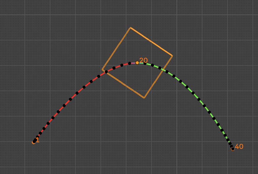

../_images/animation_motion-paths_example-object.png
An animated cube with its motion path displayed.

The paths are shown in red for the section in the past and green for the section in the future. These colors follow the user preference options "Before Current Frame" and "After Current Frame", which can be found in the 3D Viewport section. Each frame is displayed by a small dot on the paths.
The paths are automatically updated when you edit your poses/keyframes, and they are also active during animation playback. Playing the animation affects the paths only when using the Around Frame type.
