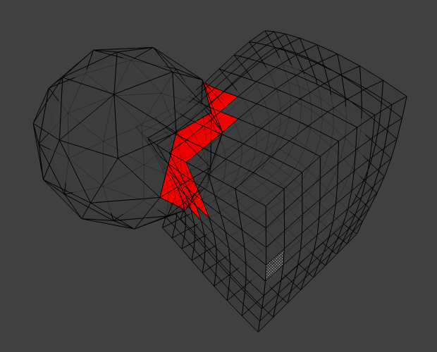

Intersections
Another common cause of problems for printing are intersections between surfaces, where the inside/outside of a model cannot be reliably detected.
Unlike other display modes, intersections have no variance and are either on or off.
../../_images/modeling_meshes_mesh-analysis_intersections.png
Intersecting faces.
