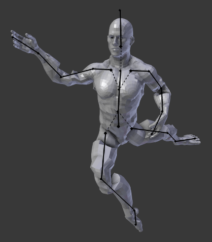

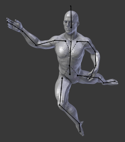

An example of a rig using bone envelopes and not weight painting.
../../../_images/modeling_modifiers_deform_corrective-smooth_example-pose-before.png
Armature only.
../../../_images/modeling_modifiers_deform_corrective-smooth_example-pose-after.png
Armature and Corrective Smooth.
