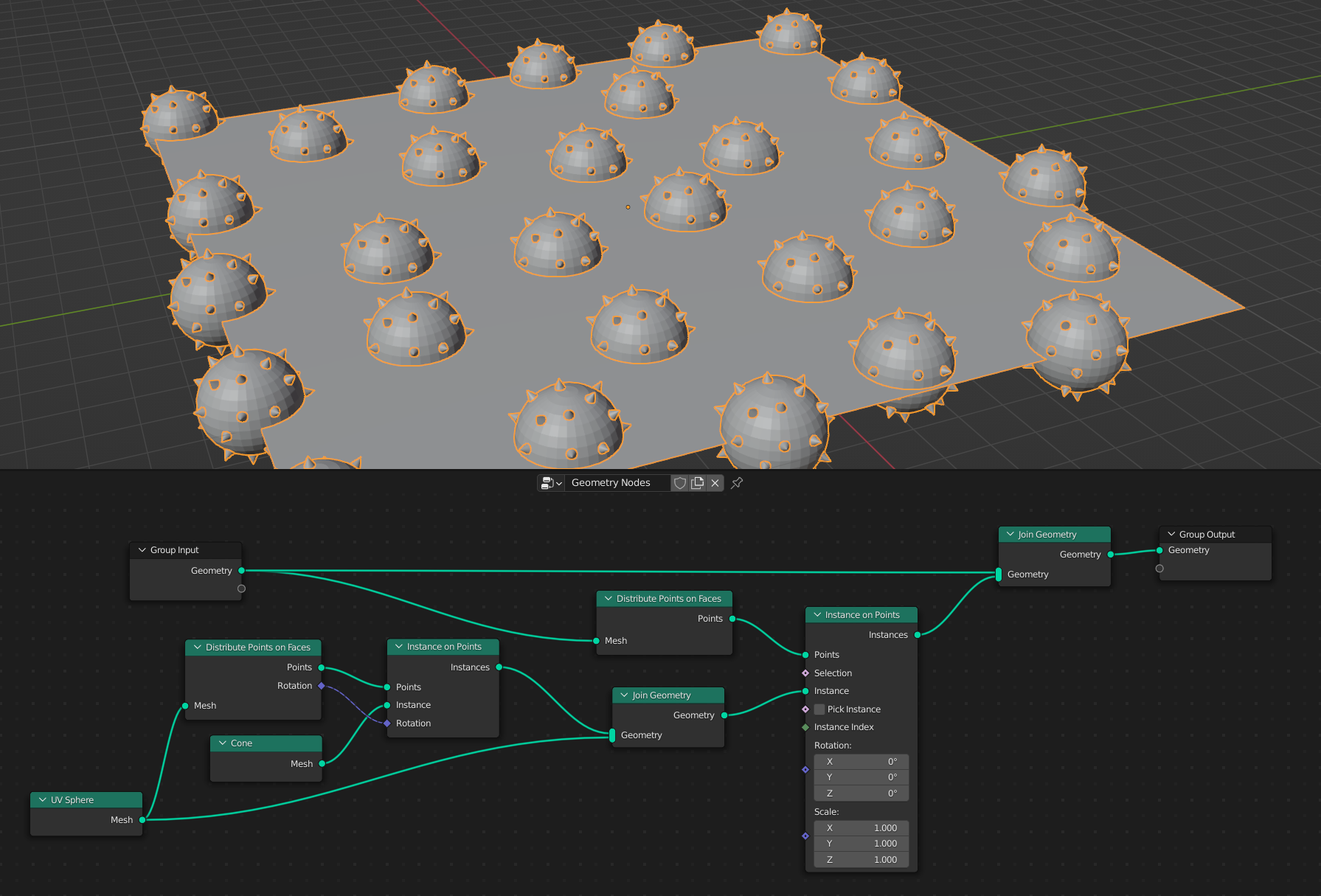

Since instances can store a geometry, and a geometry can contain instances, nested instancing is possible. In other words, it is possible to instance an instance, or even a collection of instances. For example, by default, the Instance on Points Node will create nested instances by instancing instances on the points of real geometry.
../../_images/modeling_geometry-nodes_instances-nested.png
A node group that creates nested instancing by chaining Instance on Points nodes.

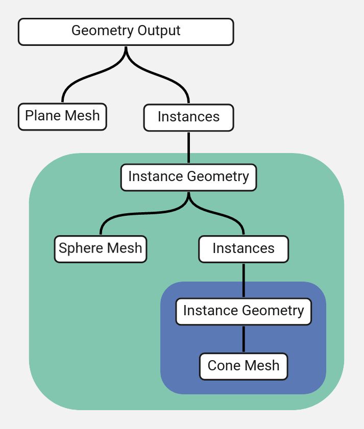

Here, nested instancing is used to distribute geometry that contains both a mesh and instances. The output geometry contains a "real" mesh and a group of instances. Each instance contains a sphere mesh and many instances of a cone geometry.
../../_images/modeling_geometry-nodes_instances-nested-tree.png
The tree of instanced geometry for the example above.
What makes this method helpful is the output geometry only contains three unique meshes: the plane, the sphere, and the cone. This would make the performance much better if the meshes were more complicated.
