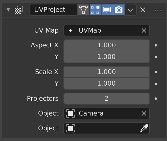

The UV Project modifier.
UV Map
Which UV map to modify. Defaults to the active rendering layer.
Aspect X/Y
Changes the image's aspect ratio. Only applies when a camera is used as projector object.
Scale X/Y
Scales the image. Only applies when a camera is used as projector object.
Projectors
Up to ten projector objects are supported. Each face will choose the closest and aligned projector with its surface normal. Projections emit from the negative Z axis (i.e. straight down a camera or light). If the projector is a camera, the projection will adhere to its perspective/orthographic setting.
Object
Specify the projector object(s).
