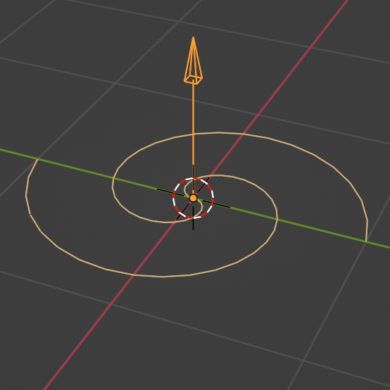

../../../_images/physics_forces_force-fields_types_vortex_visualzation.png
Vortex: force field.

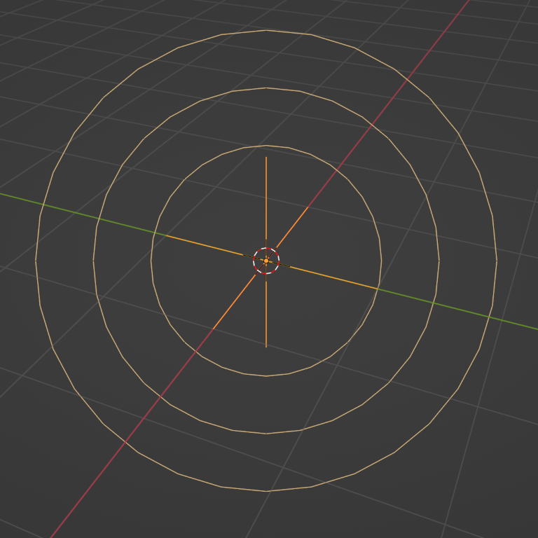

../../../_images/physics_forces_force-fields_types_wind_visualzation.png
Wind: force field.

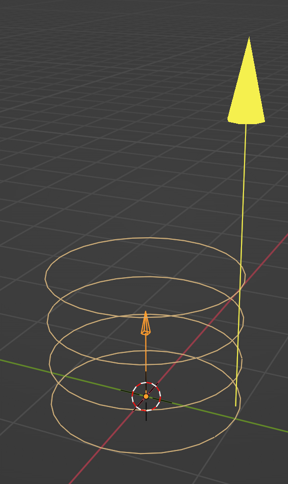

../../../_images/physics_forces_force-fields_types_force_visualzation.png
Force: force field.
