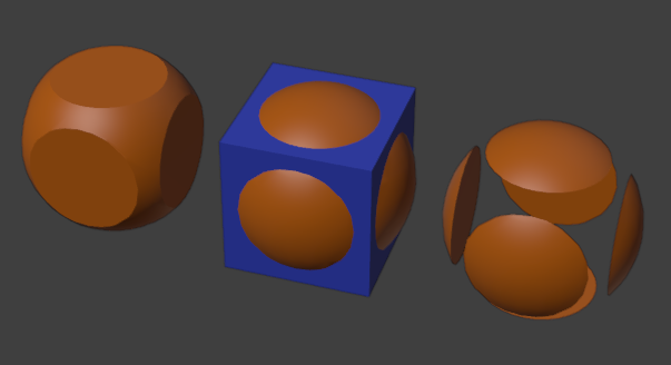

../../../_images/modeling_modifiers_generate_booleans_union-intersect-difference-examples.png
Applying the modifier to a sphere and creating the Intersection, Union, and Difference with a cube. The cube is hidden for a better view.
