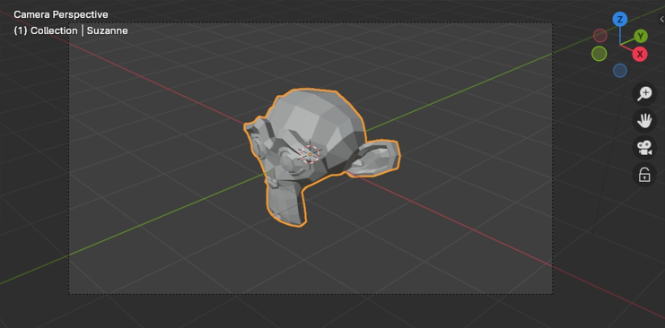

Demonstration of camera view.
The Camera view shows the current scene from the active camera's viewpoint.
The Camera view can be used to virtually compose shots and preview how the scene will look when rendered. The rendered image will contain everything within the dashed frame.
