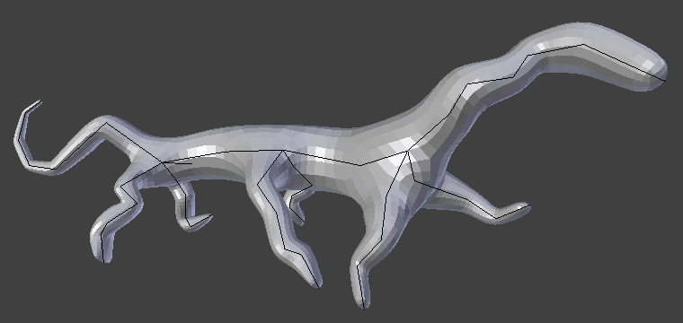

Contoh¶
Simple creature, made with only the Skin and Subdivision Surface modifiers.¶
