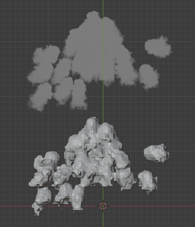

Example¶
Converting a cloud-shaped volume to a mesh.¶
