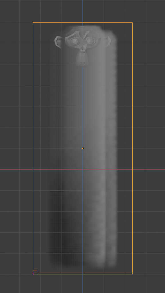

Sampling Substeps
Number of sub-steps used to reduce gaps in emission of fluid from fast-moving sources.
Comparison of smoke inflow quickly rising upwards at different sub-step rates.
../../../_images/physics_fluid_type_flow_substep-off.png
Sampling sub-steps: 0.
../../../_images/physics_fluid_type_flow_substep-on.png
Sampling sub-steps: 3.
Catatan
Sub-Steps occur at every simulation step and not per frame. The simulation step count is controlled by the adaptive time stepping.
