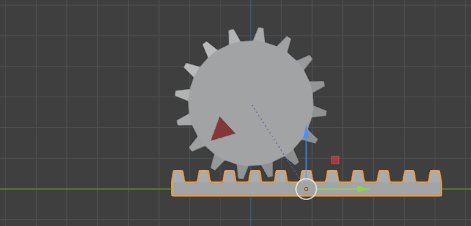

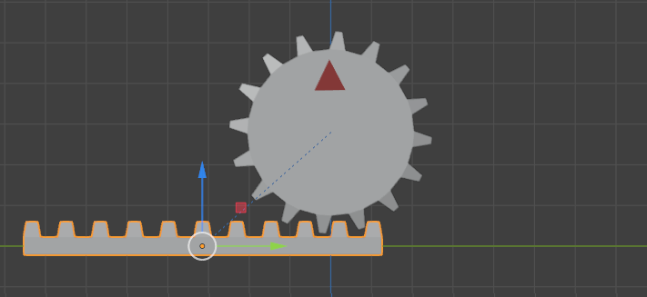

Example
In the following example, we add a constraint to a gear that sets its X rotation based on the Y position of a rail:
  • Target: Rail object
  • Map From: Location
    • Y Min: -3m
    • Y Max: 3m
  • Map To: Rotation
    • X Source Axis: Y
    • X Min: 0°
    • X Max: 180°
../../../_images/animation_constraints_transform_example_before.png
Before moving the rail.
../../../_images/animation_constraints_transform_example_after.png
After moving the rail.
By default, the gear will stop rotating if the rail goes outside the (-3m, 3m) range. You can enable Extrapolate to change this.
