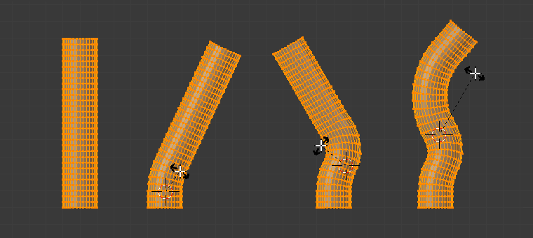

../../../../../_images/modeling_meshes_editing_mesh_transform_bend_example-usage.png
Multiple consecutive bends.
