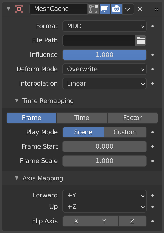

../../../_images/modeling_modifiers_modify_mesh-cache_panel.png
Mesh Cache Modifier.
Format
Specifies the input file format. The modifier currently supports .mdd and .pc2.
File Path
Path to the external cache file containing the animation data.
Influence
Controls the strength of the deformation. Lower values blend the cached animation with the original mesh shape.
Deform Mode
Determines how the cache data influences the mesh:
Overwrite:
Replaces vertex positions with those from the cache file.
Integrate:
Blends the cache deformation with existing deformations, such as shape keys or modifiers.
Catatan
This mode is best suited for minor, localized adjustments. Large transformations, such as reposing limbs, may not work as expected.
Interpolation
Controls how frames between cache data are handled:
None:
Uses only the raw frame data from the cache without interpolation.
Linear:
Blends between frames for smoother transitions, useful when cache frames do not align perfectly with the scene frames.
Vertex Group
If set, restrict the effect to only the vertices in that vertex group.
Invert
Inverts the influence of the selected vertex group, meaning that the group now represents vertices that will not be deformed by the modifier.
Time Remapping
Time Mode
Defines how animation time is interpreted:
Frame:
Ignores timing data from the cache and plays back frames directly. This mode provides direct control over playback speed.
Time:
Uses the cache's timing data, including offsets and frame durations.
Factor:
Maps the entire animation to a range between 0 and 1 for precise control.
Play Mode
Specifies how playback timing is determined:
Scene:
Uses the scene's current frame for playback.
Frame Start
Defines the starting frame for playback.
Frame Scale
Adjusts the playback speed by scaling time.
Custom:
Allows manual control of animation timing.
Evaluation Value
Determines animation playback position, which can be animated for precise control.
Axis Mapping
Forward/Up Axis
Specifies the forward and up axes of the imported animation, ensuring proper orientation.
Flip Axis
Flips the animation along a chosen axis if the imported data requires correction.
