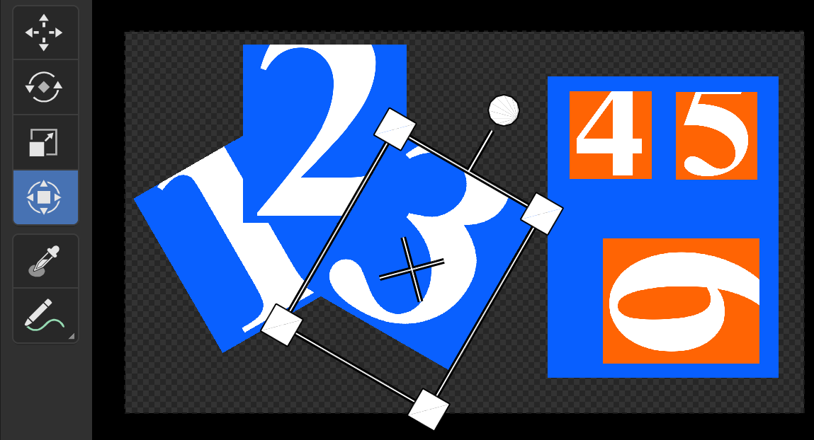

Transform
Lets you move, rotate, and scale images all using one tool.
../../../_images/editors_vse_preview_toolbar_transform.png
The Transform tool
It works as follows:
  • Drag the cross in the center to move the image.
  • Drag the dot on the protruding line to rotate.
  • Drag one of the corners to scale equally along both axes.
  • Drag one of the sides to scale along just one axis.
