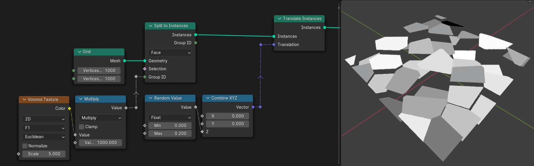

Contoh
../../../../_images/modeling_geometry-nodes_geometry_split-to-instances_example.png
In the example above, we start with a grid of 1000x1000 square faces serving as "pixels." Then, we group these faces into patches by assigning them a group ID sampled from a Voronoi texture, and move each resulting instance by a random amount along the Z axis.
Note that, because the texture outputs floating point values between 0 and 1 while the group ID is an integer, all the values would be rounded to 0 or 1 and we would only get two groups. To get more variation, we multiply the texture value by 1000.
