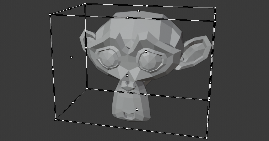

The Scale Cage tool is a bounding box around the object(s) which scales objects from a particular point or axis. The tool works by selecting a scale point and dragging inwards or outwards to adjust the scale accordingly. The origin for the scale will be from the point on the cube directly opposite from the point selected. Selecting points on the faces of the cube scales along one axis, selecting points on the edges of the cube scales along two axes, and selecting points on the vertices of the cube scales along all three axes.
../../../_images/scene-layout_object_tools_scale-cage_example.png
Scale Cage tool.
