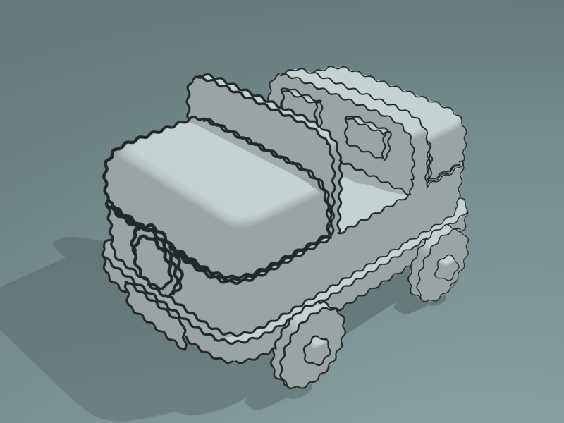

Sinus Displacement modifier demo by T.K. (blend-file).¶
