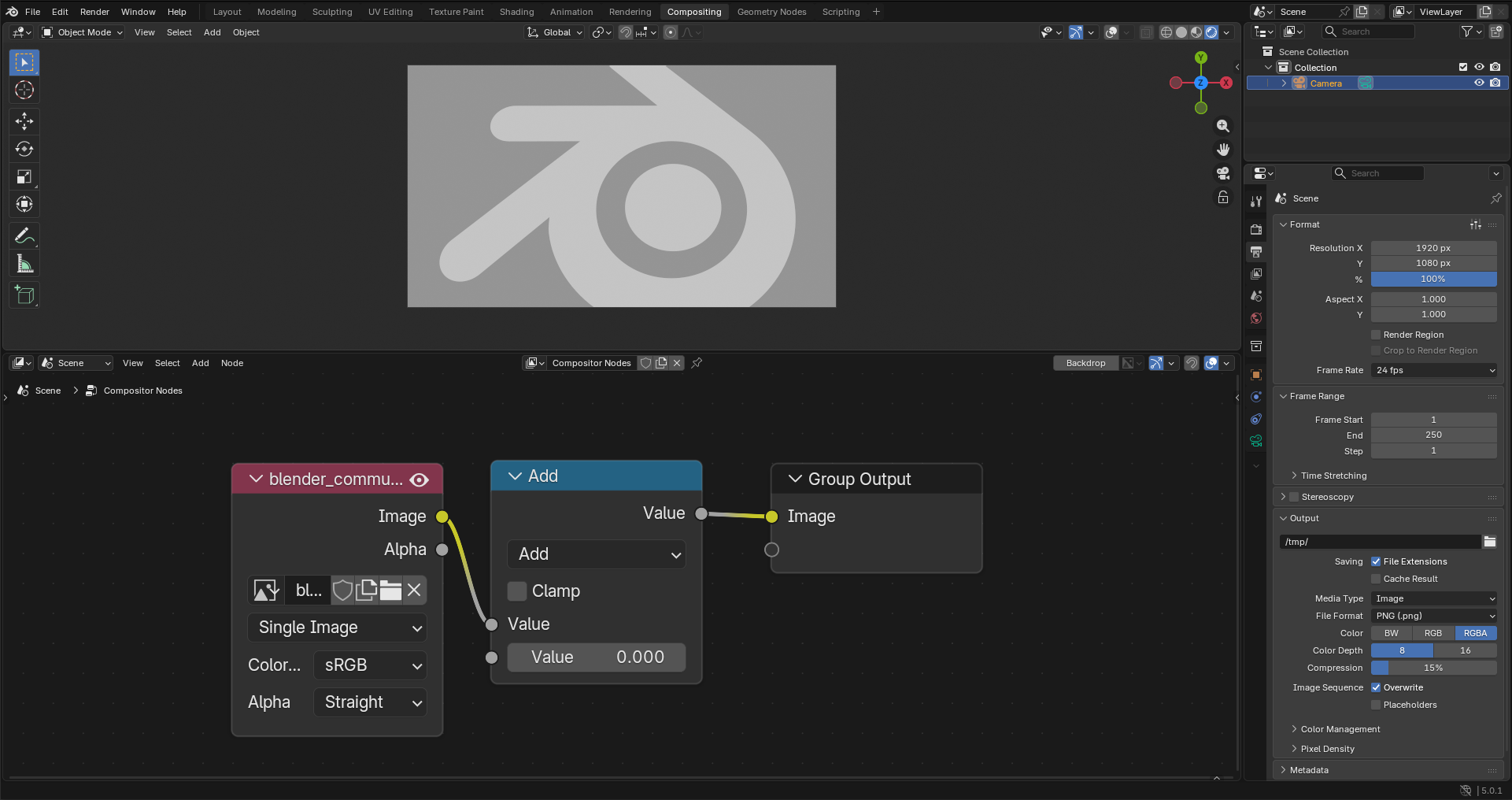

The following example demonstrates implicit conversion between a color type and a float type, since the Math Node expects float inputs.
../_images/compositing_realtime-compositor_compositing-space_data_type_implicit_conversion.png
An example that demonstrates implicit conversion between a color type and a float type, since the Math node expects float inputs.
