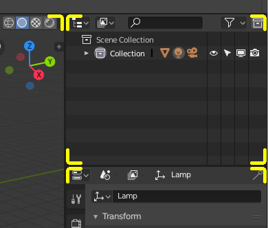

../../_images/interface_window-system_areas_borders.png
Area boundaries are indicated by rounded corners (yellow highlights).
The Blender window is divided into a number of rectangles called Areas. Areas reserve screen space for Editors, such as the 3D Viewport or the Outliner. Each editor offers a specific piece of functionality.
Areas are grouped into Workspaces, which are geared towards particular tasks (modeling, animating and so on).
