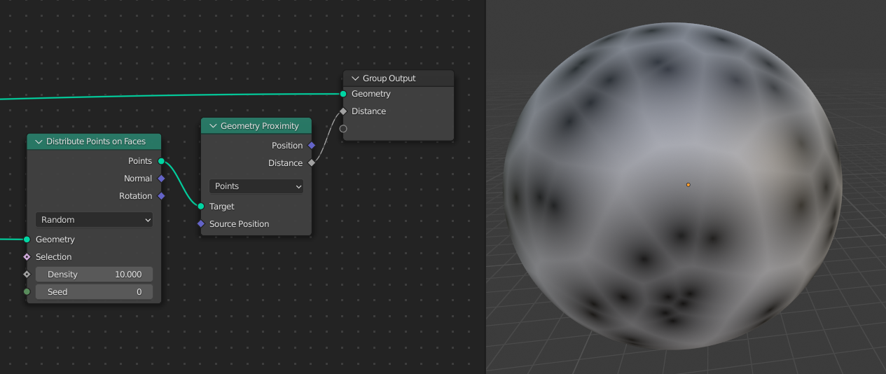

Points distributed on a sphere used as a target for a distance used in a shader.¶
