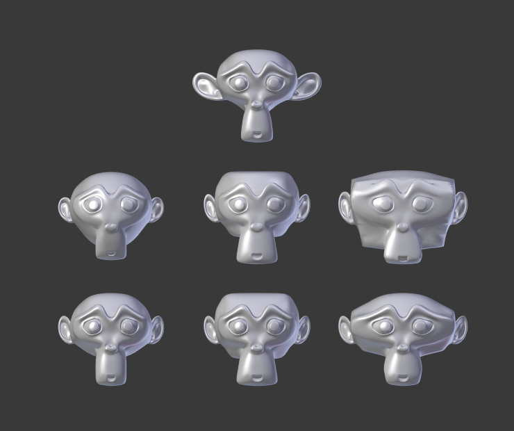

Example
../../../_images/modeling_modifiers_deform_cast_example.jpg
Top: Suzanne without modifiers. Middle: Suzanne with each type of Cast Modifier (Sphere, Cylinder and Cuboid). Bottom: Same as above, but now only X axis is enabled. Sample blend-file.
