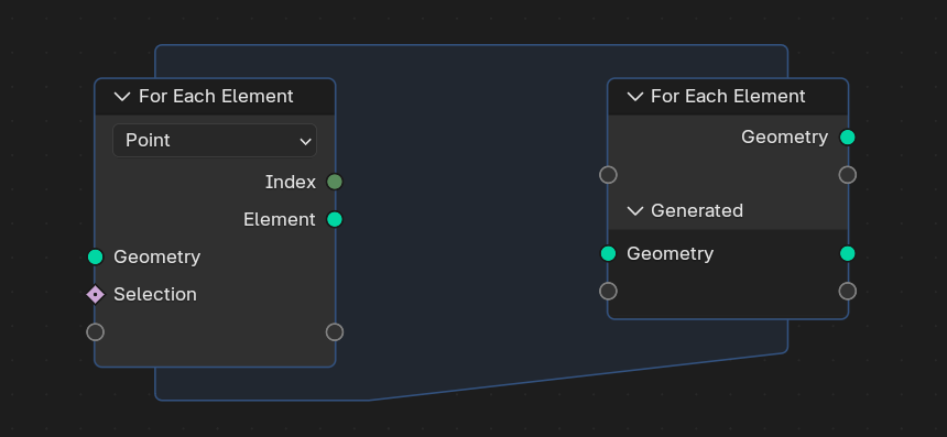

For Each Geometry Element Zone
This zone type allows executing nodes for each element of a geometry. For example, the nodes can process every face of a mesh, or every instance.
../../../_images/modeling_geometry-nodes_foreach_geometry_element_zone.png
The For Each Element zone.
The zone is ideal for tasks that generate large or complex geometry for every element of an input geometry. For example, generating a unique tree for every input curve, or a unique building on every input face.
