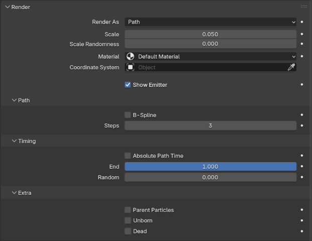

Path
../../../_images/physics_particles_emitter_render_path.png
The Visualization panel for Path visualization.
The Path visualization needs a Hair particle system or Keyed particles.
B-Spline
Interpolate hair using B-splines. This may be an option for you if you want to use low Render values. You lose a bit of control but gain smoother paths.
Steps
Set the number of subdivisions of the rendered paths (the value is a power of 2). You should set this value carefully, because if you increase the render value by two you need four times more memory to render. Also the rendering is faster if you use low render values (sometimes drastically). But how low you can go with this value depends on the waviness of the hair (the value is a power of 2). This means 0 steps give 1 subdivision, 1 give 2 subdivisions, 2 → 4, 3 → 8, 4 → 16, ... 𝓃 → 2𝓃.
Timing
Referensi
Panel:
Particle System ‣ Render ‣ Timing
Type:
Hair
Absolute Path Time
Path timing is in absolute frames.
End
End time of the practical path.
Random
Give the path length a random variation.

Parents Particles
Render also parent particles if child particles are used. Children have a lot of different deformation options, so the straight parents would stand between their curly children. So by default Parents are not rendered if you activate Children. See Children.
Unborn
Render particles before they are born.
Dead
Render particles after they have died. This is very useful if particles die in a collision Die on hit, so you can cover objects with particles.
