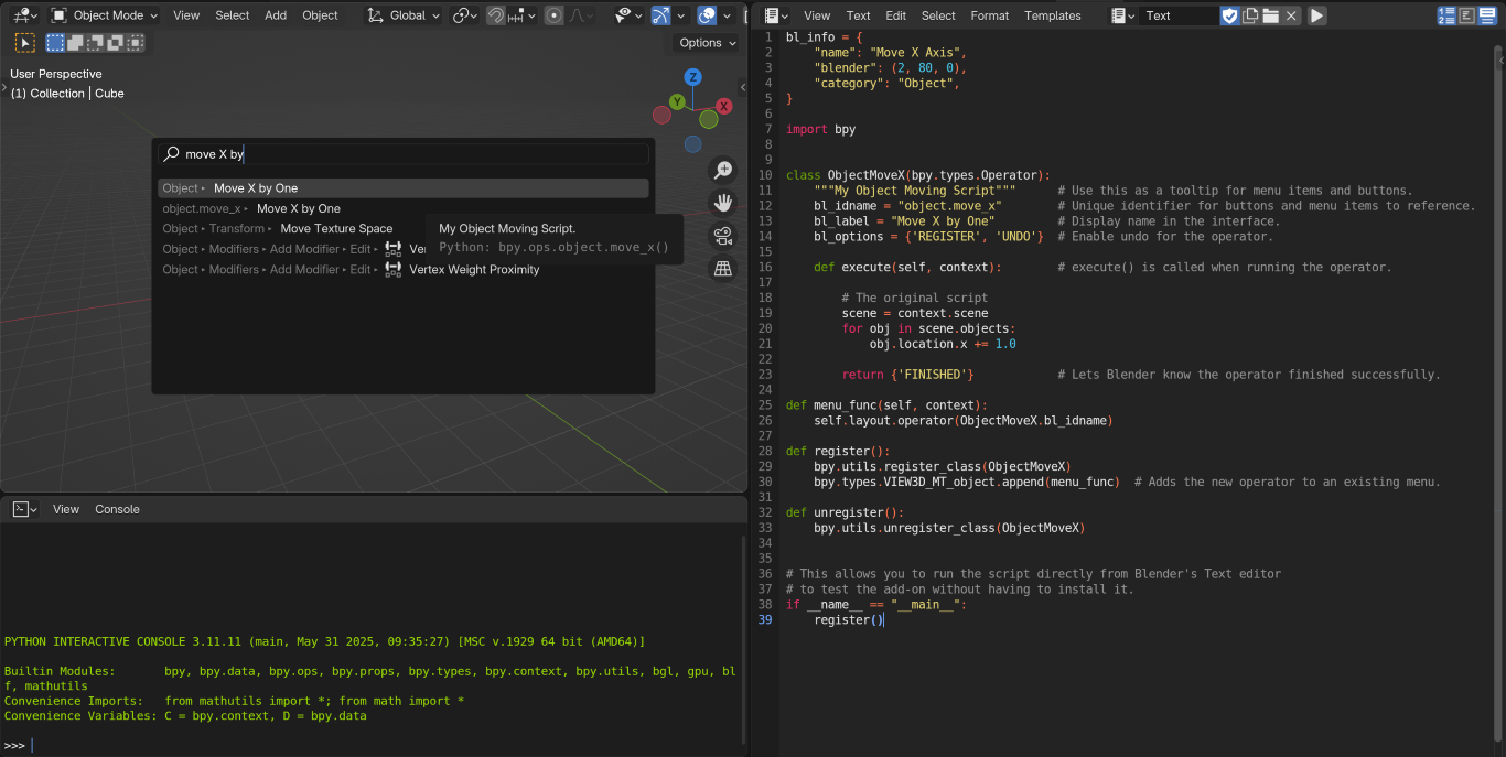

To test the script, you can copy and paste it into Blender’s Text editor and run it. This will execute the script directly and call register immediately.
However running the script won’t move any objects. For this, you need to execute the newly registered operator.
../../_images/advanced_scripting_addon-tutorial_operator-search-menu.png
Operator Search menu.
Open the Operator Search menu and type in “Move X by One” (the bl_label), then Return.
The objects should move as before.

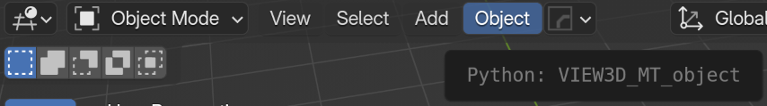

../../_images/advanced_scripting_addon-tutorial_in-menu.png
In the menu.
Run the script (or save it and add it through the Preferences like before) and it will appear in the Object menu.
../../_images/advanced_scripting_addon-tutorial_op-prop.png
Operator Property.
After selecting it from the menu, you can choose how many instances of the cube you want create.
