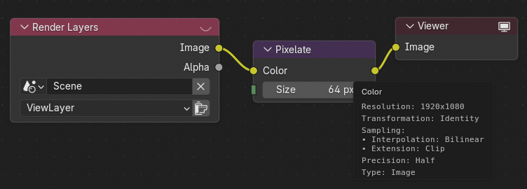

Socket Inspection
../_images/compositing_socket-inspection.png
Socket Inspection.
Socket inspection displays information about the image contained in a socket after the node tree has been evaluated.
Rather than displaying the image itself, the inspection panel summarizes properties of the image, making it easier to verify intermediate results and debug node trees.
The following information is displayed:
  • Resolution – Displays the image resolution. If the image has a display window, both the data window and display window are shown instead.
  • Transform – Displays the image transform. If no transformation has been applied, Identity is shown. Otherwise, the translation, rotation, and scale are displayed.
  • Sampling – Displays the interpolation and sampling modes used by the image.
  • Precision – Indicates whether the image is stored using Full or Half precision.
Bemerkung
Socket values are only available after the node tree has been evaluated. Nodes that do not contribute to the final output are generally not evaluated and therefore have no inspection data available.
Bemerkung
Pixel sockets are currently not supported.
