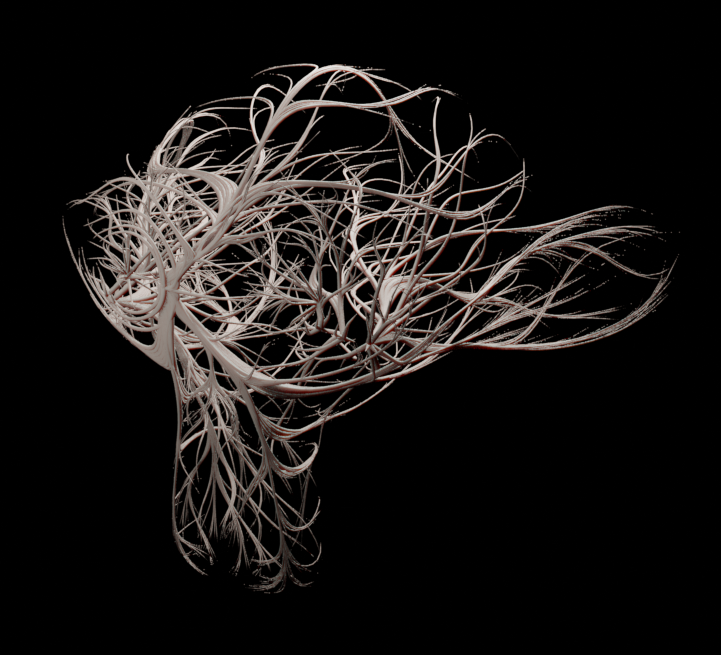

../../../../_images/modeling_geometry-nodes_shortest_edge_paths_example-3.png
Organic branching structure on Suzanne.
