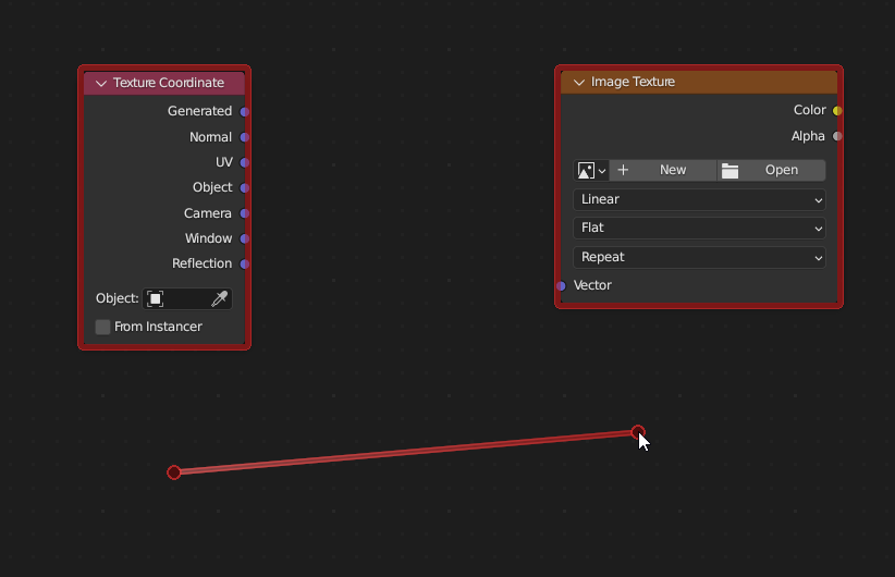

Lazy Connect¶
Reference (Referentie)
- Shortcut (Sneltoets):
Alt-RMK-sleep, Shift-Alt-RMK-sleep
Connect two nodes without even clicking the sockets. Just drag the cursor from one node to another while holding Alt-RMB. It will select the nodes nearest the start and end points of the drag for connection, so you don’t even have to click on the nodes.
Selectie kan lui zijn.¶
It tries to connect the best-matched sockets possible, based on their names, types, and whether they are open or not.
For a more precise connection, you can alternatively use Shift-Alt-RMB. It brings up menus of available inputs and outputs before connection, so you can select the exact sockets to connect. It’s especially useful when working with a large node tree since you can make connections without frequently zooming in and out.

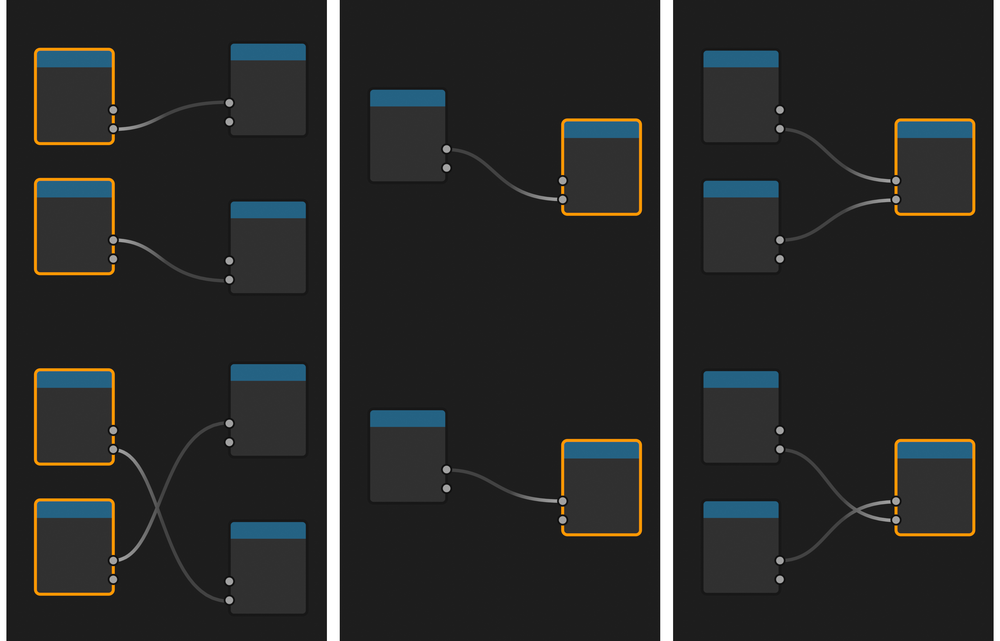

Swap Links¶
- Menu:
Alt-S
When two nodes are selected, this swaps each other’s output link. Note that some output connections can be lost if the two nodes have a different number of connected outputs.
With one node selected, if the node has one linked input, it cycles the link through the available input sockets. If the node has two linked inputs, it swaps those two links. If there are more than two inputs linked, it swaps the two inputs with matching types (the Mix node’s two Color inputs, for example).

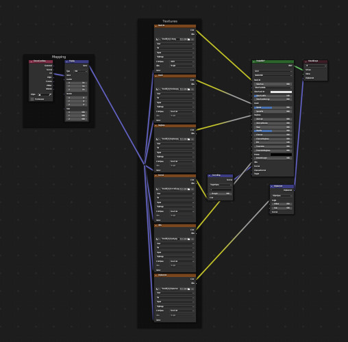

Add a principled texture setup from the selected texture files. Select a Principled BSDF node, select Add Principled Setup from the quick access menu (or press Shift-Ctrl-T), and select texture files. It automates the process of adding Image Texture nodes, loading images, selecting the appropriate Color Space, and connecting their outputs to the Principled BSDF node.
It detects the type of textures by looking at their file names. You can edit the tags used for this matching process in the add-on preferences.
Setting up these textures can take dozens of clicks, even with Node Wrangler’s other tools. With Principled Texture Setup, you can reduce that to a few clicks.¶
