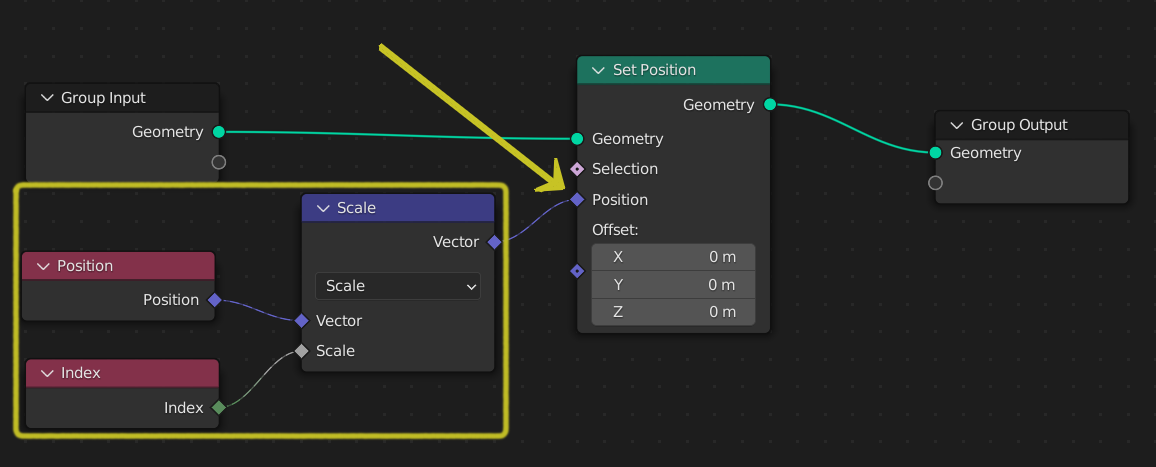

A field input to a node.
For example, in the figure above, the field connected to the “Set Position” node depends on two inputs, Position and Index, and transforms them into a vector using a single instruction.

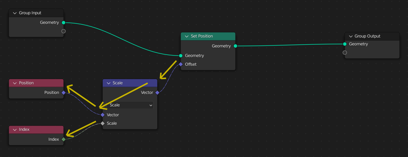

../../_images/modeling_geometry-nodes_fields_flow-1.png
Here, the Set Position node’s input field is evaluated once. To evaluate the field, the node traverses backwards to retrieve the inputs from the field input nodes.

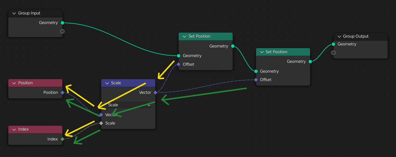

../../_images/modeling_geometry-nodes_fields_flow-2.png
When a second Set Position node is added, the same field node tree is evaluated twice, once for each data flow node. At the second Set Position node, the results will be different since its geometry input will already have the changed position from the first node.

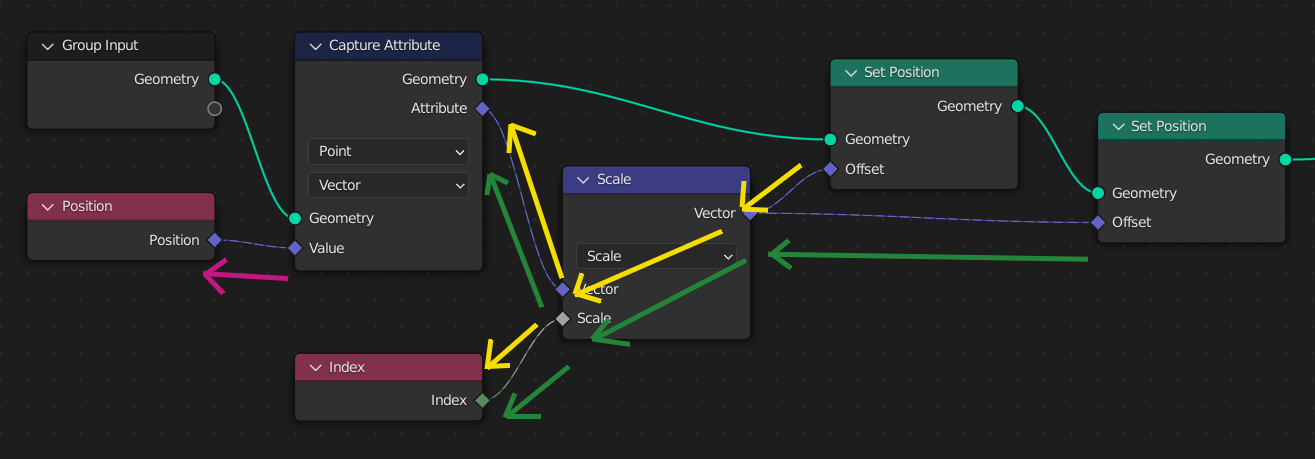

../../_images/modeling_geometry-nodes_fields_flow-3.png
However, often it’s necessary to use the same field values even after changing the geometry. The Capture Attribute Node evaluates a field, copying the result to an anonymous attribute on the geometry.
Here, a Capture Attribute node stores a copy of the initial position. Notice that evaluating the field input of the Capture Attribute node is an entirely different step. Later on, the input fields to the Set Position nodes don’t use the actual position, but the anonymous attribute copy of it.
