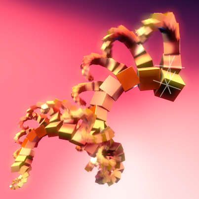

Array offset
An empty can be used to offset an Array Modifier, meaning complex deformations can be achieved by only moving a single object.
../_images/modeling_modifiers_generate_array_example-fractal-1.jpg
An example of an empty being used to control an array.
