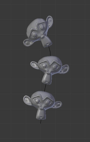

../../../_images/modeling_modifiers_deform_curve_example-monkeyoncurve1.png
Monkey on a curve.
../../../_images/modeling_modifiers_deform_curve_example-monkeyoncurve2.png
Monkey deformations.
