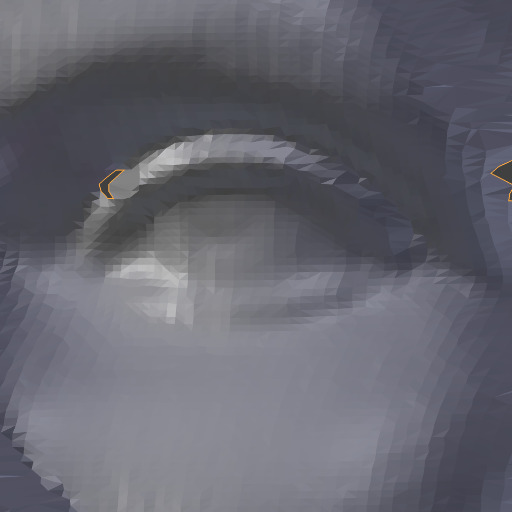

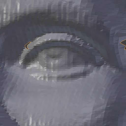

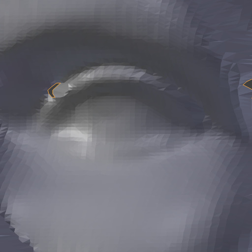

Lambda Factor
Controls the amount of displacement of every vertex along the flow curvature.
  • Using a small Factor, you can remove noise from the shape without affecting desirable geometry.
  • Using a large Factor, you get smoothed versions of the shape at the cost of fine geometry details.
  • Using a negative Factor, you can enhance the shape, preserving desirable geometry.
  • When the Factor is negative, multiple iterations can magnify the noise.
../../../_images/modeling_modifiers_deform_laplacian-smooth_repeat0.jpg
Factor: 0.0.
../../../_images/modeling_modifiers_deform_laplacian-smooth_lambda0-5.jpg
Factor: 0.5.
../../../_images/modeling_modifiers_deform_laplacian-smooth_lambda.jpg
Factor: 2.5.
../../../_images/modeling_modifiers_deform_laplacian-smooth_lambda5-0.jpg
Factor: 5.0.
../../../_images/modeling_modifiers_deform_laplacian-smooth_cube-lambda0-0.png
Factor: 0.0.
../../../_images/modeling_modifiers_deform_laplacian-smooth_cube-lambda1-0.jpg
Factor: 1.0.
../../../_images/modeling_modifiers_deform_laplacian-smooth_cube-lambda10-0.jpg
Factor: 10.0.
../../../_images/modeling_modifiers_deform_laplacian-smooth_cube-lambda50-0.jpg
Factor: 50.0.
../../../_images/modeling_modifiers_deform_laplacian-smooth_camel-repeat0.jpg
Factor: 0.0.
../../../_images/modeling_modifiers_deform_laplacian-smooth_camel-lambda20-0.jpg
Factor: -20.0.
../../../_images/modeling_modifiers_deform_laplacian-smooth_camel-lambda50-0.jpg
Factor: -50.0.
../../../_images/modeling_modifiers_deform_laplacian-smooth_camel-lambda300-0.jpg
Factor: -300.0.
