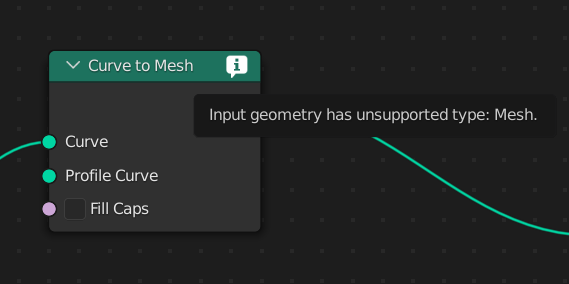

Node Warnings¶
Node Warning.¶
When the inputs to a node are invalid, it displays a warning in the title. Hovering over the warning icon shows the error message. These warnings are only generated when the node is executed, so a node must be connected to the Group Output to have a warning.

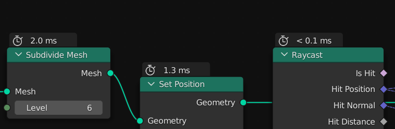

Node Timings Overlay¶
The node timings overlay.¶
Node timings show how long a node took to execute the last time the node group was evaluated. They can be turned on in the overlays popover on the top right of the node editor. When a node group is used in multiple places, the timings depend on the context of the node editor, which is displayed in the path on the top left.
Frame nodes display the total time from all of the contained nodes and the Group Output node displays the total time for the entire node group.
The displayed timings should only be considered an approximation, since they can also take into account actions like copying or deleting a geometry input that aren’t part of the node’s operation. Also, when a node uses multiple CPU cores, the evaluation system might work on other nodes at the same time. It’s also important to remember that field nodes generally don’t do work by themselves, so their execution time is only added to the data-flow nodes they are connected to.
