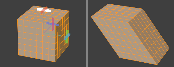

Set up a pivot point and optionally a transform orientation. Pick an axis on the gizmo that matches the desired “above”/”below” direction (which determines how much each vertex should be sheared). Finally, drag the handle that matches the desired “horizontal” direction (in which the vertices should be moved).
../../../../../_images/modeling_meshes_editing_mesh_transform_shear_tool.png
Using the Shear tool.
