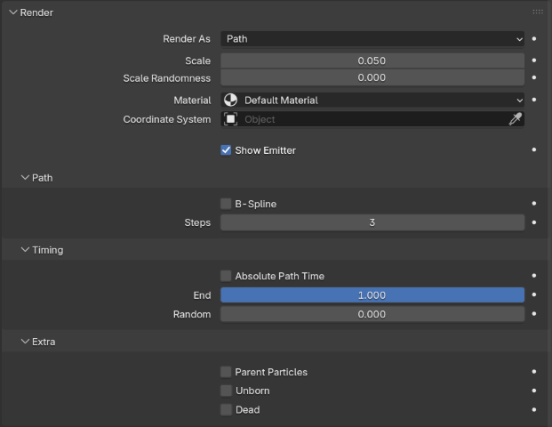

The Render Panel controls how particles appear when they are rendered.

Common Settings
Schaal (Scale)
Scale Randomness
Materiaal
Set which of the object’s materials is used to shade the particles.
Coordinates System
Use a different object’s coordinates to determine the birth of particles.
Show Emitter
When disabled, the emitter is no longer rendered. Activate the button Emitter to also render the mesh.
Render As
None (Geen)
When set to None, particles are not rendered. This is useful if you are using the particles to duplicate objects.
Halo
Halos are rendered as glowing dots or a little cloud of light. Although they are not really lights because they do not cast light into the scene like a light object. They are called Halos because you can see them, but they do not have any substance.
Path (Pad)
../../../_images/physics_particles_emitter_render_path.png
The Visualization panel for Path visualization.
The Path visualization needs a Hair particle system or Keyed particles.
B-Spline
Interpolate hair using B-splines. This may be an option for you if you want to use low Render values. You lose a bit of control but gain smoother paths.
Steps (Stappen)
Set the number of subdivisions of the rendered paths (the value is a power of 2). You should set this value carefully, because if you increase the render value by two you need four times more memory to render. Also the rendering is faster if you use low render values (sometimes drastically). But how low you can go with this value depends on the waviness of the hair (the value is a power of 2). This means 0 steps give 1 subdivision, 1 give 2 subdivisions, 2 → 4, 3 → 8, 4 → 16, … 𝓃 → 2𝓃.
Timing
Reference (Referentie)
Panel (Paneel):
Particle System ‣ Render ‣ Timing
Type (Type):
Hair
Absolute Path Time
Path timing is in absolute frames.
End (Eind)
End time of the practical path.
Random (Willekeurig)
Give the path length a random variation.

Extra
Panel (Paneel):
Particle System ‣ Render ‣ Extra
Parents Particles
Render also parent particles if child particles are used. Children have a lot of different deformation options, so the straight parents would stand between their curly children. So by default Parents are not rendered if you activate Children. See Children.
Unborn
Render particles before they are born.
Dead
Render particles after they have died. This is very useful if particles die in a collision Die on hit, so you can cover objects with particles.
