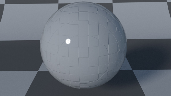

Examples (Voorbeelden)
../../../_images/render_shader-nodes_vector_bump_node-setup.png
The above node setup will only bump the diffuse part of the shader, simulating a bumpy diffuse surface coated with a smooth glossy “glaze” layer.
../../../_images/render_shader-nodes_vector_bump_example.jpg
