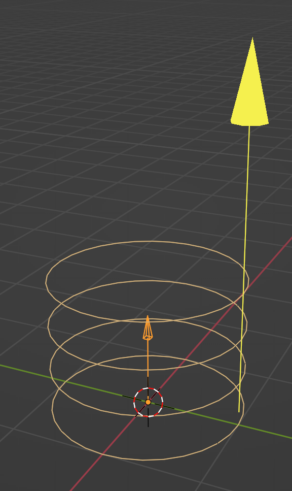

To create a single force field, you can select Add ‣ Force Field and select the desired force field. This method creates an empty with the force field attached.
Examples of an empty with the force field attached.
../../../_images/physics_forces_force-fields_types_vortex_visualzation.png
Vortex: force field.
../../../_images/physics_forces_force-fields_types_wind_visualzation.png
Wind: force field.
../../../_images/physics_forces_force-fields_types_force_visualzation.png
Force: force field.
