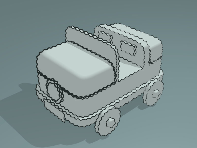

The undulations this modifier produces look exactly the same at a Phase of
0and any positive or negative multiple of theWavelengthset on the modifier. This can be used for rendering short video sequences with wavy lines that can then be seamlessly looped without any visual jumps in the undulations along the line.
Sinus Displacement modifier demo by T.K. (blend-file).¶
