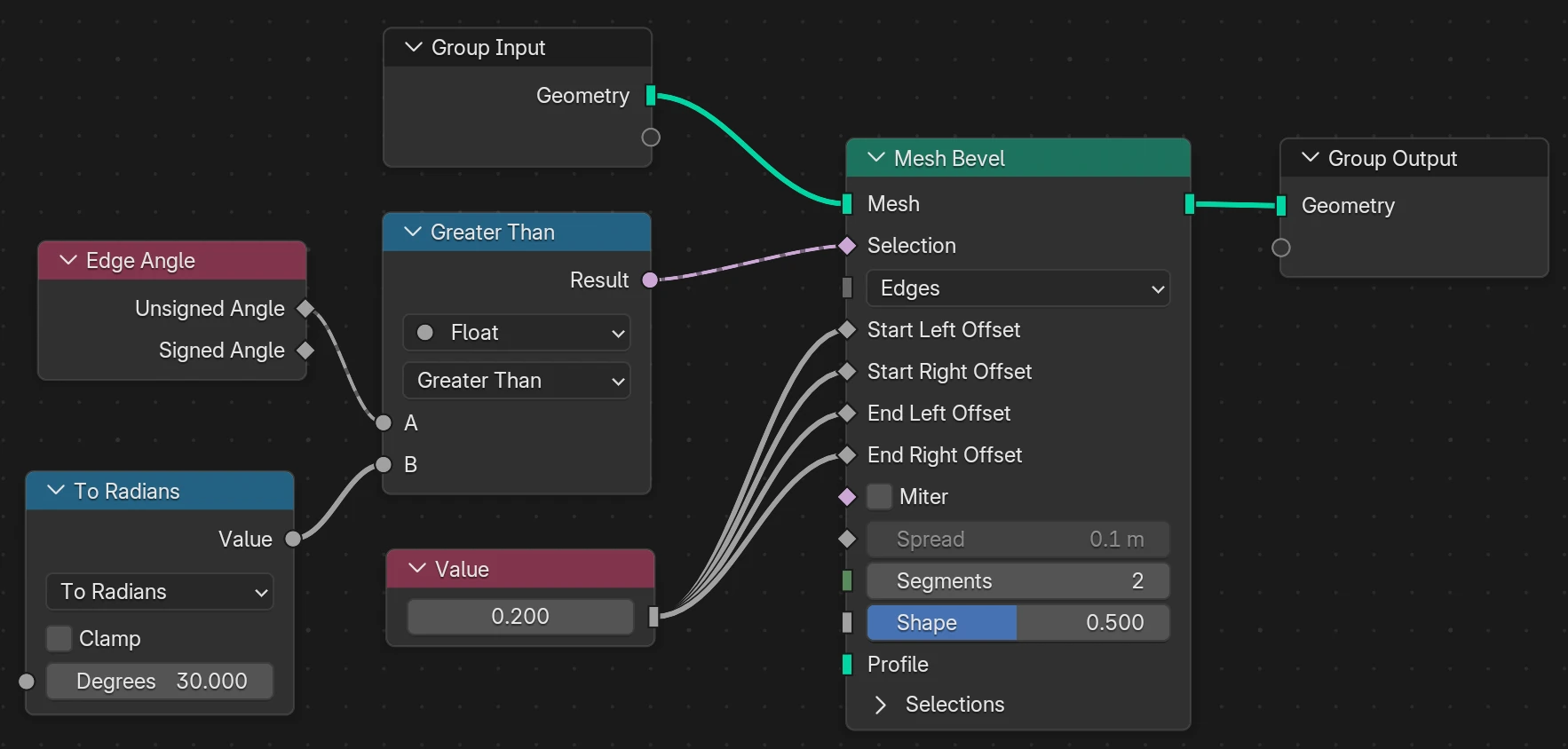

Examples (Voorbeelden)
A number of controls are available in the bevel modifier but not in the bevel node. Most of these controls can be achieved by adding nodes in front of the inputs or after the outputs.
For example, to apply the Angle Limit Method control, we can make use of an Edge Angle node to measure the angle between the two faces attached to a manifold edge, and then compare that to a desired threshold and use the result of that comparison to select the edges to bevel.
Angle Limit example.
