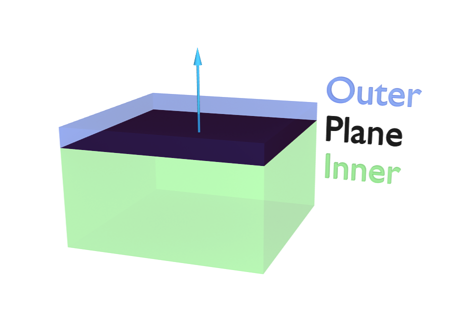

Thickness (Dikte)
A padding distance is added to the inside and outside of each face, to help to prevent intersections. The soft body will come to rest at this distance away from the face of the colliding object. Outside and inside is defined by the face normal, depicted as blue arrow in Fig. A soft body vertex colliding with a plane..
Outer
Size of the outer collision zone.
Inner
Size of the inner collision zone (padding distance).
../_images/physics_collision_outer-inner.png
