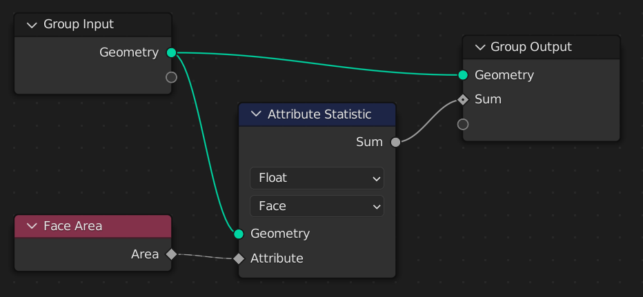

../../../../_images/modeling_geometry-nodes_input_face-area_surface-area.png
Combined with the Attribute Statistic Node, this node can be used to calculate the total surface area of a mesh.
