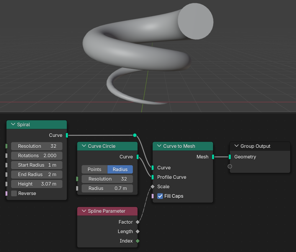

Examples (Voorbeelden)
../../../../_images/modeling_geometry-nodes_curve_curve-parameter_example.png
The parameter used to control the radius of the curve. The beginning of the spline has a radius of 0, the end has a radius of 1.
