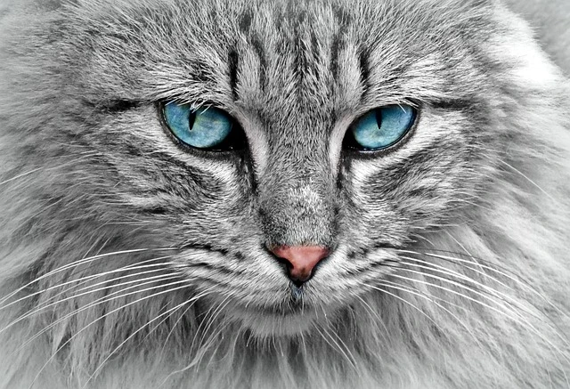

../../../_images/compositing_types_filter_kuwahara-node_original.webp
Original.

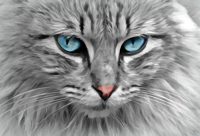

../../../_images/compositing_types_filter_kuwahara-node_size3.webp

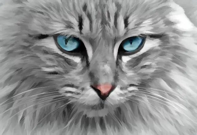

../../../_images/compositing_types_filter_kuwahara-node_size6.webp

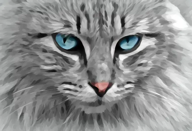

../../../_images/compositing_types_filter_kuwahara-node_size9.webp
